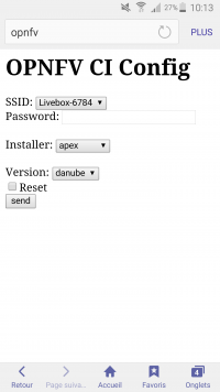

The version 2 will scan the SSID around the object and configure the wemos as access point. Then you will have to directly connect to it, you will get a html form when connecting to http://opnfv/ in a browser (once you are connected to the wemos)
This form will ask:
  • SSID
  • SSID password
  • installer
  • version
